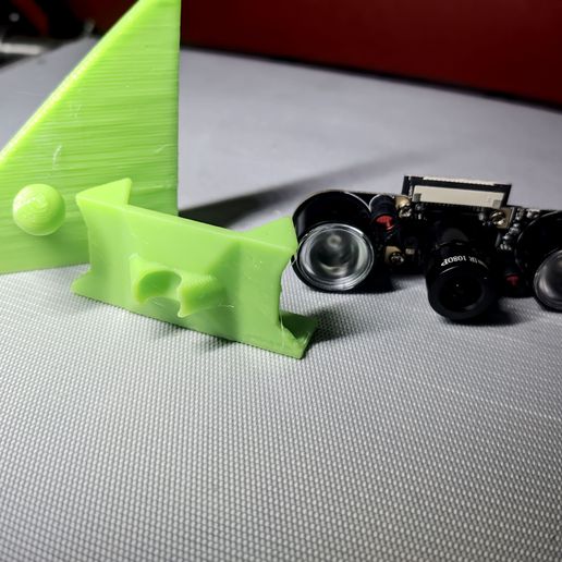

Hello all :p
I own an iFactory One and I like this machine, I also like the fact that it is equipped with a raspberry camera, but I often print at night, and the camera quickly becomes useless, or asks to leave the light lit all night to monitor or do a timelap.
So I bought an infrared raspberry camera to allow filming anytime even without light.

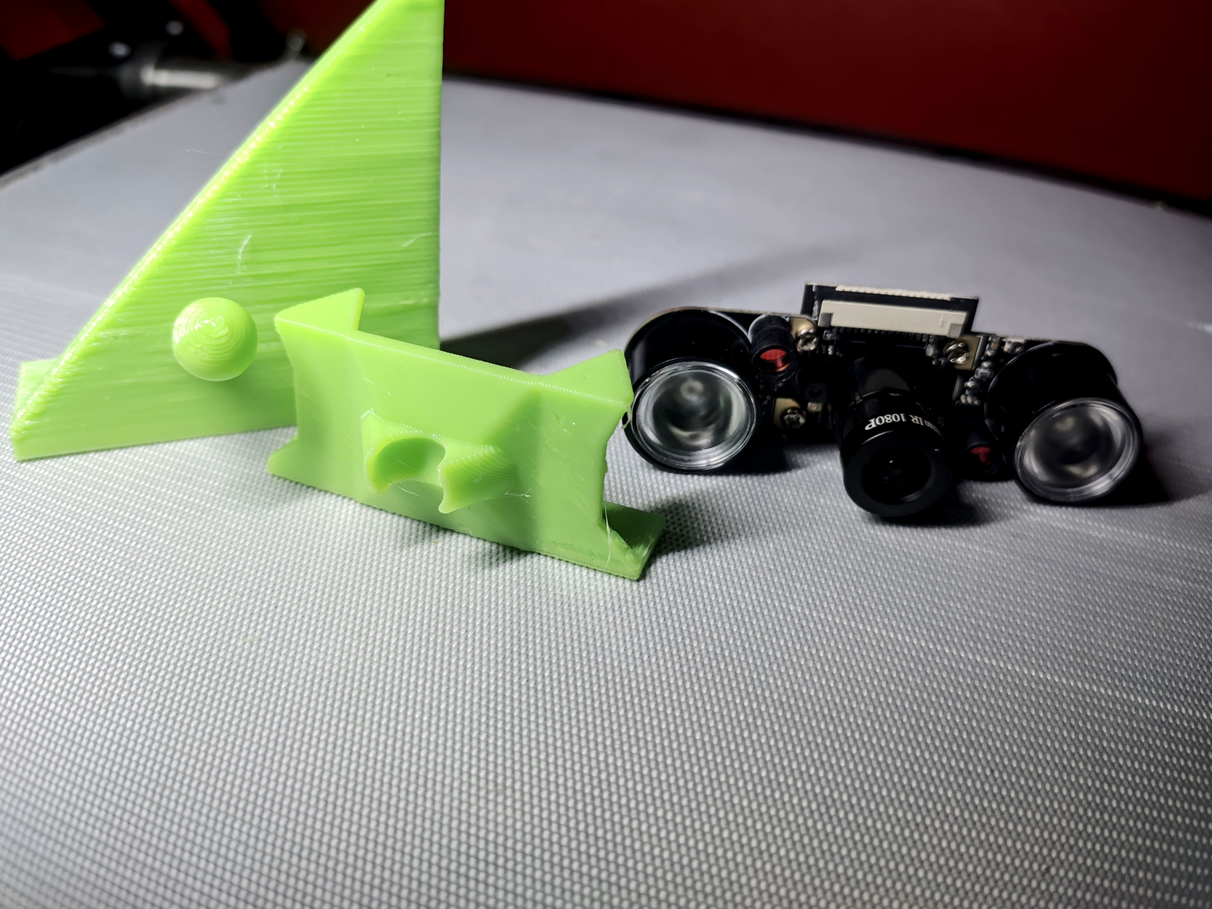

So I created this adapter which clips the most easily in the world on the camera and holds very well thanks to the small collar provided for this purpose) and is put on the original ball present on the iFactory.
Please check which version of infrared camera you buy, you need the ones where the plastic plate of the camera does not protrude (a new version is planned to accept this camera too.
The object is designed and rotated by default to be printable on the iFactory without any support or part to clean or cut, just print, clip the camera, put it on the ball and go.
Created by Zoltan3D
You can find files here :
Don"t hesitate to come back to speak about your experience.
