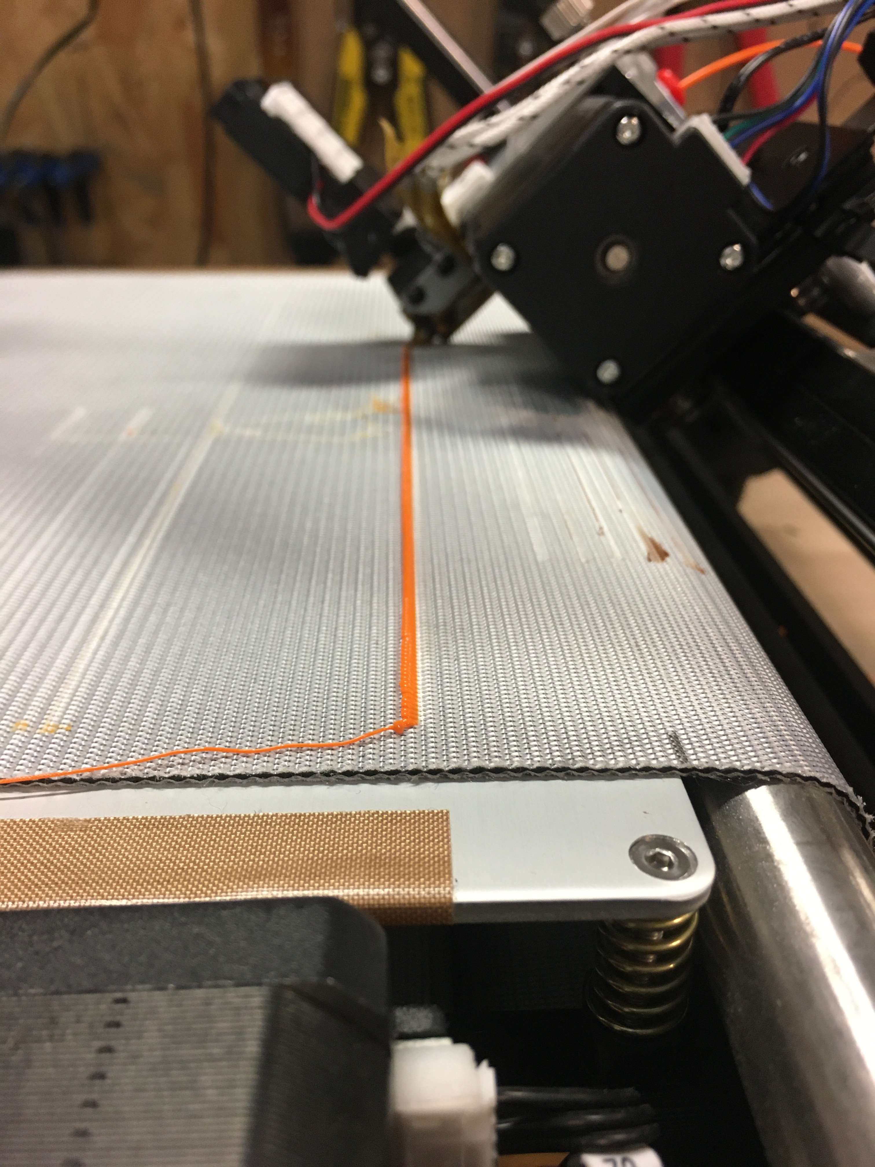

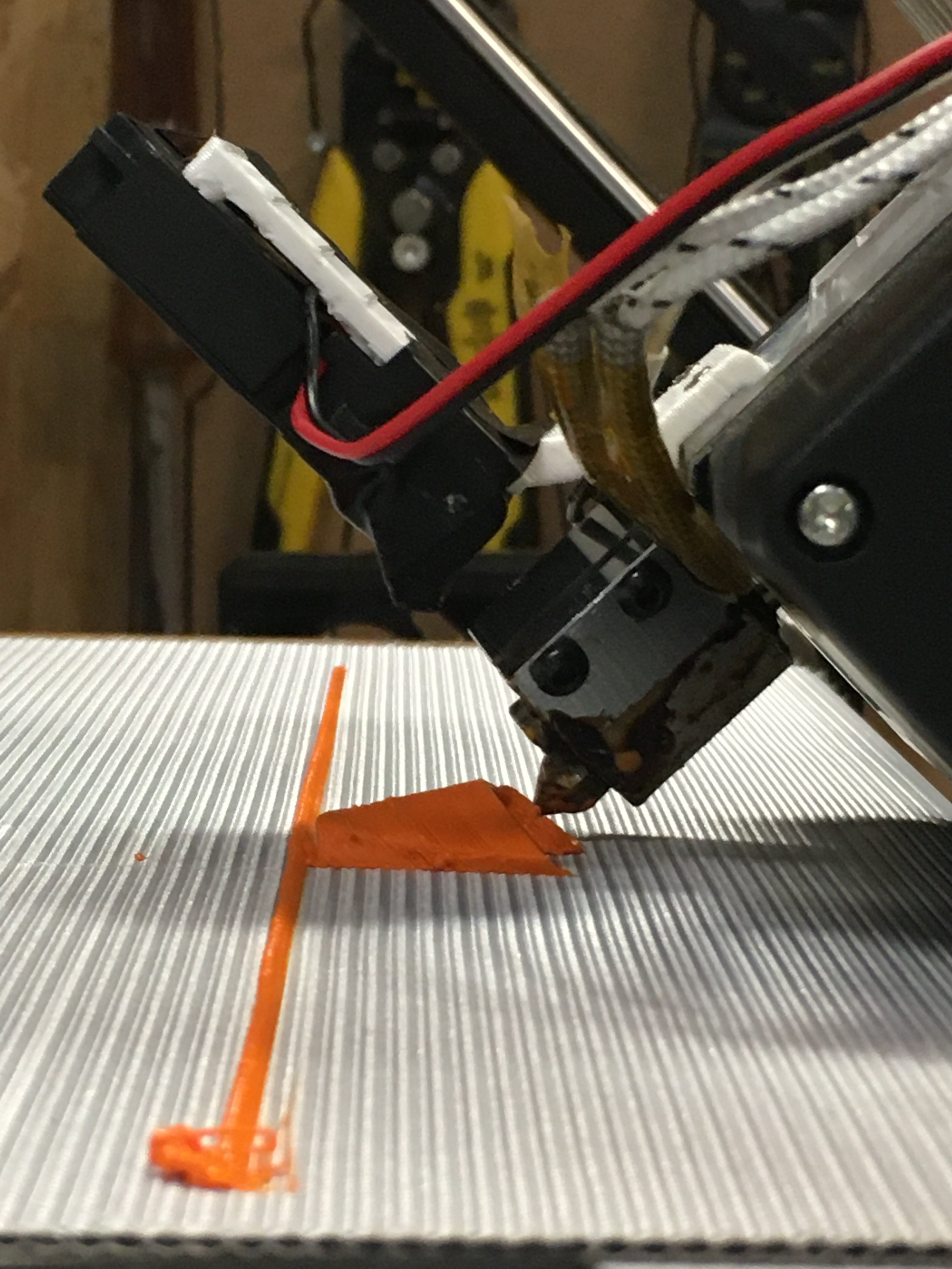

Bellow I show the results of my current extrusion: (you can see the printing file forming a blob by the amount of filament)
